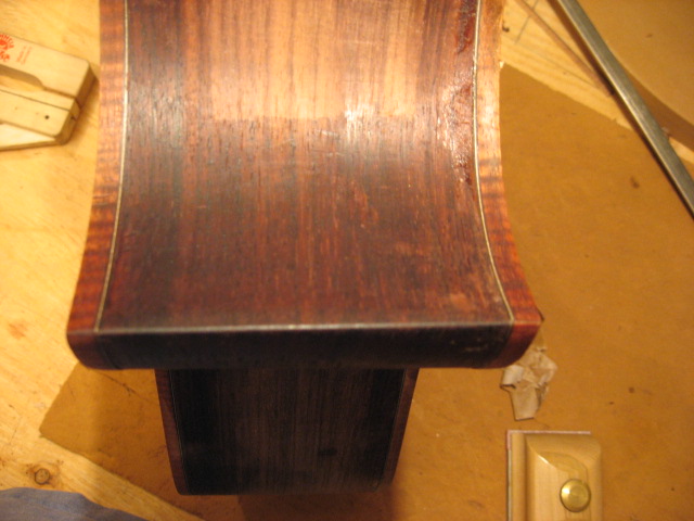

So I've made it through what is for me, the most unnerving thing in guitar building; binding!!!
I'm always apprehensive when it come to binding. I'm usually on my guard and ultra paranoid, even when I'm not in the shop!    That's why I try to get it over and done with as quickly, but safely, as possible...

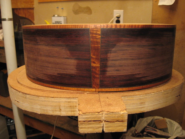

So here's how it came out. Flamed koa with thin B/W/B laminations (From one of our great sponsors, Shane at Highmountain!) This binding is really gorgeous to look at with very deep flame and it has some of the nicest dark purplish streaks...

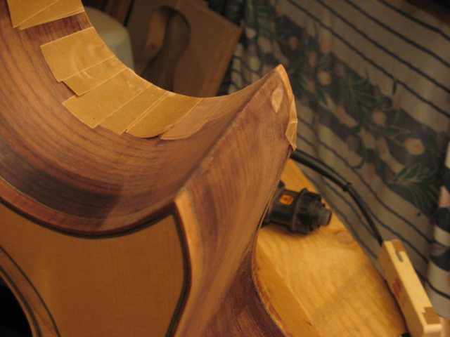

Looking inside the horn.

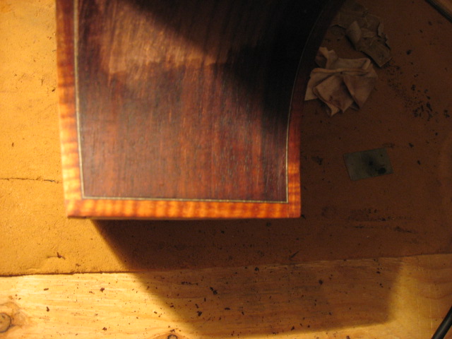

All done!

WOW!! Alain! I think you have binding down now! That end graft looks as good as it can get!

I really wanted my miters to improve on this one. On my first two I used single white lines (1/32). Those were murder to get right.
These are about 1/16 and they were a bit easier to get just so...
I'm thinking that I'd like to try even bolder purfling on the next. Wider is probably easier to miter...
Billy, all told with the routing of the channels, cleaning them up... I glue in the top purfling seperatly too because I don't want any cracks between the purf and spruce... I know I know... that's the hard way of doing it... It must have taken me close to 10 hours, if not a bit more...   I had to make 3 pieces to fit the horn, top side before I was happy with the result... Alain Desforges39043.5501041667

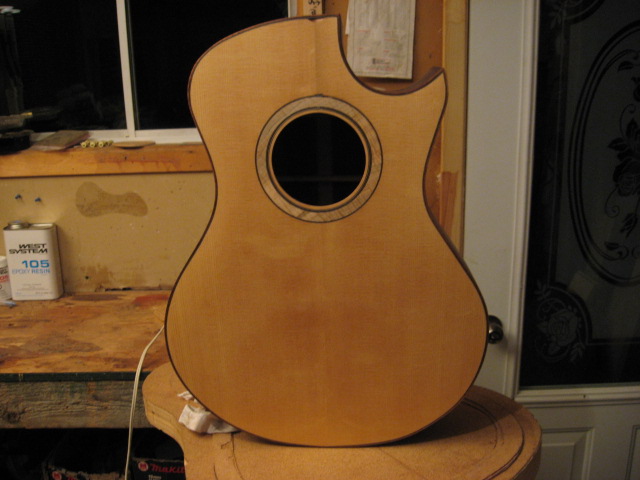

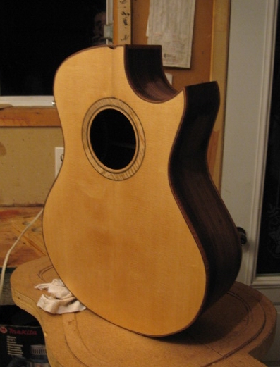

Here's another shot of the body... I must admit that I'm rather proud of the shape...

Looks great Al. I love the mitre on the cutaway! Super clean looking. Keep up the good work, I can't wait to see it finished.

Beautifil work Alain! I'd love to know how you got that seam on the front of the cutaway. From here it looks like you just magically bent the wood 120 degrees right around the cutaway!!!

Joe, this is how I sort of went about it. After bending the side up to that point I just figured where I wanted my imaginary line to be, the line where the miters would meet.
I marked the angle on top of the rim and at the upper-most point (the very tip) I carried a straight line across the side just to show me where the edge would/should be.
I cut the side about an inch past the 'point' and I free handed the angle/mitre on my benchtop sander using the 4 inch belt on top. I was careful to keep the piece nice and perpendicular and I kept a watchfull eye on the line that runs across the side.
After a few adjustments I got the point to fit tightly.
When I was ready to glue I started by the tail block, then the neck block to the non cutaway side. I glued the horn to the neck block and I finished with the point. I used titebond on the blocks but I used HHG on the point. I had a lot of 'meat' in the joint, actually. I'm sure I had over 1/8. I wanted a glue that didn't need a tonne of clamping pressure. I just held it by hand for what seemed like an eternity and I taped it up with binding tape.
After that, I used the inside of the guitar as a sanding caul to fit a small wedge of mahogany in the tip. I just wrapped a piece of sandpaper inside the guitar holding it tight with one hand and I sanded away. The little wedge fit airtight and I glued that in there using HHG as well.
Jon, I glued the side purfs to the binding beforehand. Only the top purfling gets glued in on it's own. I know this is maybe a long way of doing it, but I find the end result, for me, is worth it. It just seems that no matter how hard I try to machine a perfect 1/16 little channel for the purfling I just can't get it to be, well... perfect.
After I glue on the perfling I just clean up the rest of the channel around it. I'm always careful not to dig in the purfling. That first black line is only like 0.02. I'll use a mix of chisel, Gramil and emery boards to get that cleaned up.
When I glue the rest of the binding on, it there's a crack to be had, at least it will be between the purfling and the binding and not towards the spruce.   A little drop of CA (after sealing the top with shellac) takes care of the little crack. The repair is invisible. Spruce slivers on the other hand...
As for the end-graft miters, I followed Cumpiano and Nathelson's advice in Tradition and Technology. PM me if you want further details. I also have a tonne of pics if anyones interested.
